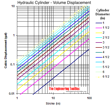

Hydraulic cylinder - volume displacement graph
Example - Hydraulic Cylinder and Volumetric Displacement
A 4" cylinder with a cylinder area 12.57 in2 makes a 30" stroke. The cubic displacement can be calculated as
 q = (12.57 in2) (30 in) / 231
    = 1.63 gal
