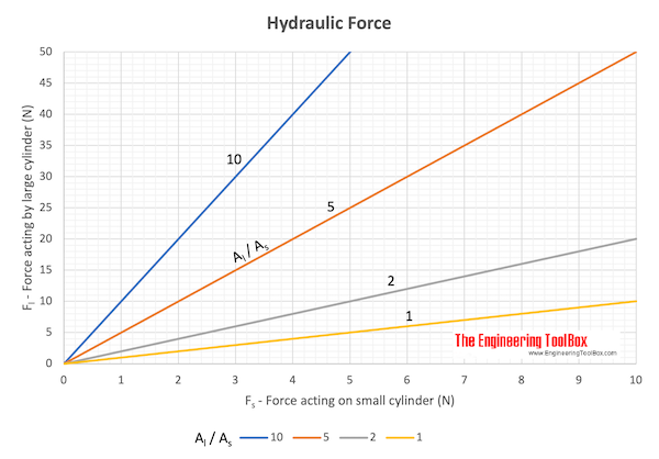

Example - Force in a Hydraulic Jack
hydraulic jack
The pressure acting on both pistons in a hydraulic jack is equal.
hydraulic lift
The force equation for the small cylinder:
F s = p A s (2)
F s = force acting on the piston in the small cylinder (N)
A s = area of small cylinder (m2)
p = pressure in small and large cylinder  (Pa, N/m2)
The force equation for the large cylinder:
F l = p A l (2b)
F l = force acting on the piston in the large cylinder (N)
A l = area of large cylinder (m2)
(2) and (2b) can be combined to
F s / A s = F l / A l (2c)
or
F s = F l A s / A l (2d)
The equation indicates that the effort force required in the small cylinder to lift a load on the large cylinder depends on the area ratio between the small and the large cylinder - the effort force can be reduced by reducing the small cylinder area compared to the large cylinder area.
Hydraulic force chart
A Hydraulic Jack Lifting a Car
The back end (half the weight) of a car of mass 2000 kg is lifted by an hydraulic jack where the A s / A l ratio is 0.1 (the area of the large cylinder is 10 times the area of the small cylinder).
The force - weight - acting on the large cylinder can be calculated with Newton's Second Law:
F l = m a
m = mass (kg)
a = acceleration of gravity (m/s2)
or
F l = 1/2 (2000 kg) (9.81 m/s2)
= 9810 (N)
The force acting on the small cylinder in the jack can be calculated with (2d)
F s = (9810 N) 0.1
= 981 (N)
