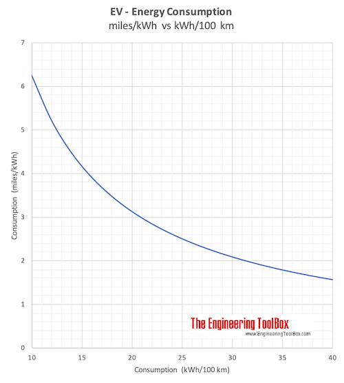

The energy consumption in Electric Vehicles - EV - can be specified as miles per kWh or kWh per 100 km where
EkWh/100 km = 100 / (1.6 Emiles/kWh)                    (1)
Emiles/kWh = 100 / (1.6 EkWh/100 km)                    (2)
EkWh/100 km = energy consumption (kWh/100km)
Emiles/kWh =  energy consumption (miles/kWh)
Example - Energy Consumption specified as 2.9 miles/kWh
can be converted to
EkWh/100 km = 100 / (1.6 (2.9 miles/kWh))
                 = 21.6 kWh/100 km
EV - Electric Vehicle - Consumption Converter
Convert between miles/kWh and kWh/100 km chart
Electric Vehicle - EV - Convert between miles per kWh and kWh per 100 km
Download miles per kWh vs. kWh per 100 km chart
