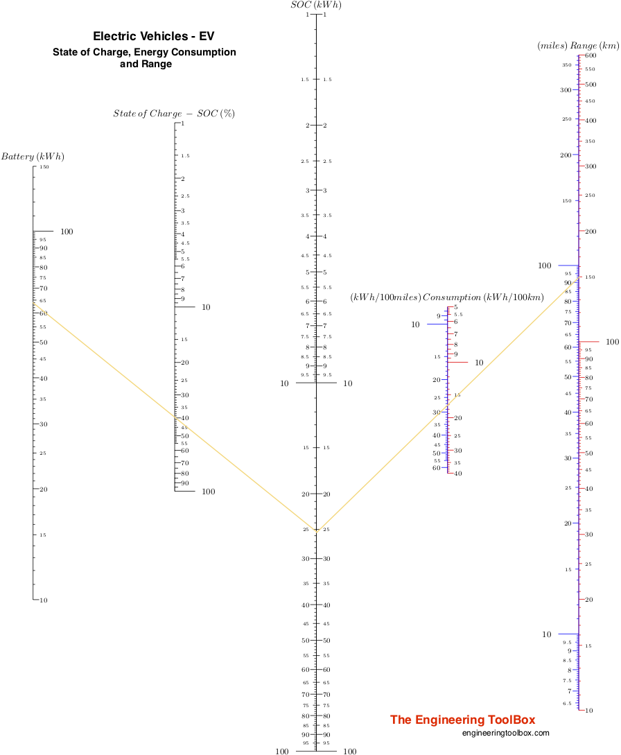

The chart below can be used to estimate the range of an electric vehicle based on size of battery, state of charge and energy consumption. The chart can also be used the "other way round" by estimating required state of charge from range. See the examples below.
The default values are for battery size 64 kWh, State of Charge SOC 40% and 25.5 kWh, energy consumption 17 kWh/100km (28 kWh/miles) and range 150 km (93 miles).
EV -  Electric Vehicle - Battery Size, State of Charge SOC, Energy Consumption and Range
Download and print EV - Electric Vehicle - Battery Size, State of Charge SOC, Energy Consumption and Range Chart!

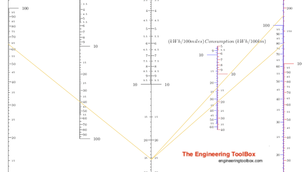

Example - Estimating Range
With battery size 64 kWh, state of charge 40% or 25.5 kWh and energy consumption 14 to 20 kWh/100km - the range of the electric vehicle can be estimated to be 130 to 180 km as indicated below.

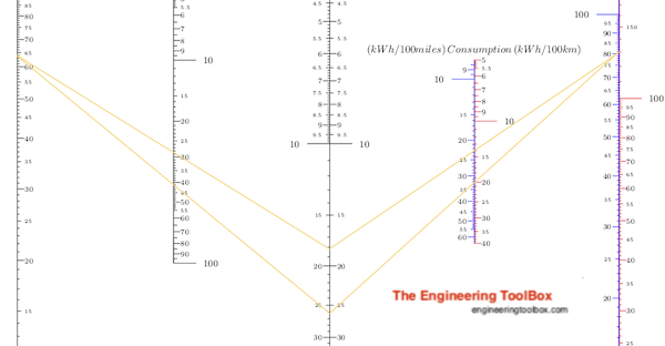

Example - Estimating Required State of Charge - SOC
With trip distance 130 km, energy consumption 14 to 20 kWh/100km and battery size 64 kWh - the required state of charge can be estimated to be 18 - 26 kWh or 28 - 42% as indicated below.
