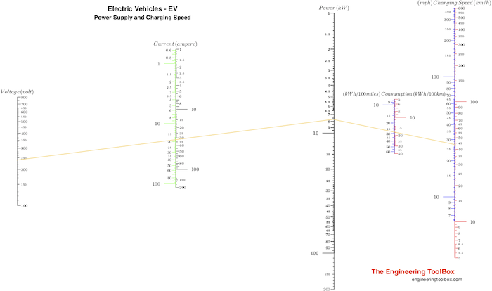

The same calculation as above but with single phase current (A) and voltage (V) as input instead of power (kW).
Electrical Vehicle - Power Supply and Charging Speed Diagram
The diagram below can be used to estimate charging speed for electrical vehicles. The default values are for single phase 240V, 32 amps, 7.7 kW, 18 kWh/100km driving consumption - and charging speed 43 km/h.
Electrical vehicle power supply and charging speed diagram
Download and print Electrical vehicle charging speed diagram!

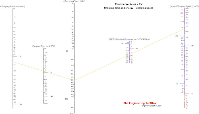

Electric Vehicle - Charging Time and Energy - Charging Speed Calculator
Electrical Vehicle - Charging Time and Energy - Charging Speed Diagram
The diagram below can be used to estimate charging speed for electrical vehicles. The default values are for 13 minutes, 9 kWh, 42 kW, 18 kWh/100km driving consumption - and charging speed 230 km/h.
Electrical vehiclecharging energy, time and  charging speed diagram
Download and print electrical vehicle charging energy, time and charging speed diagram!
