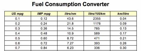

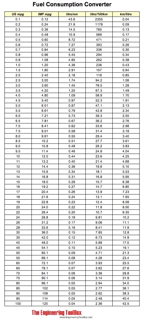

The table below can be used to convert between common gasoline and diesel consumption units like
  • US MPG - Miles per Gallon
  • Imperial MPG - Miles per Gallon
  • l/nm - litre per nautical mile
  • l/100 km
  • km/litre
Fuel Consumption Converter
US mpg
Imp mpgliter/nmliter/100 kmkm/liter
0.10 0.12 43.61 2355.00 0.04
0.20 0.24 21.81 1177.50 0.09
0.30 0.36 14.54 785.00 0.13
0.40 0.48 10.90 588.75 0.17
0.50 0.60 8.72 471.00 0.21
0.60 0.72 7.27 392.50 0.26
0.70 0.84 6.23 336.43 0.30
0.80 0.96 5.45 294.38 0.34
0.90 1.08 4.85 261.67 0.38
1.00 1.20 4.36 235.50 0.43
1.50 1.80 2.91 157.00 0.64
2.00 2.40 2.18 117.75 0.85
2.50 3.00 1.74 94.20 1.06
3.00 3.60 1.45 78.50 1.28
3.50 4.20 1.25 67.29 1.49
4.00 4.80 1.09 58.88 1.70
4.50 5.40 0.97 52.33 1.91
5.00 6.01 0.87 47.10 2.13
5.50 6.61 0.79 42.82 2.34
6.00 7.21 0.73 39.25 2.55
6.50 7.81 0.67 36.23 2.76
7.00 8.41 0.62 33.64 2.98
7.50 9.01 0.58 31.40 3.19
8.00 9.61 0.55 29.44 3.40
8.50 10.21 0.51 27.71 3.61
9.00 10.81 0.48 26.17 3.83
9.50 11.41 0.46 24.79 4.04
10.00 12.01 0.44 23.55 4.25
11.00 13.21 0.40 21.41 4.68
12.00 14.41 0.36 19.63 5.10
13.00 15.61 0.34 18.12 5.53
14.00 16.81 0.31 16.82 5.95
15.00 18.02 0.29 15.70 6.38
16.00 19.22 0.27 14.72 6.80
17.00 20.42 0.26 13.85 7.23
18.00 21.62 0.24 13.08 7.65
19.00 22.82 0.23 12.39 8.08
20.00 24.02 0.22 11.78 8.50
22.00 26.42 0.20 10.70 9.35
24.00 28.82 0.18 9.81 10.20
26.00 31.23 0.17 9.06 11.05
28.00 33.63 0.16 8.41 11.90
30.00 36.03 0.15 7.85 12.75
35.00 42.04 0.12 6.73 14.88
40.00 48.04 0.11 5.89 17.00
45.00 54.05 0.10 5.23 19.13
50.00 60.05 0.09 4.71 21.25
55.00 66.06 0.08 4.28 23.38
60.00 72.06 0.07 3.93 25.50
65.00 78.07 0.07 3.62 27.63
70.00 84.07 0.06 3.36 29.75
75.00 90.08 0.06 3.14 31.88
80.00 96.08 0.05 2.94 34.00
85.00 102.09 0.05 2.77 36.13
90.00 108.09 0.05 2.62 38.25
95.00 114.10 0.05 2.48 40.38
100.00 120.10 0.04 2.36 42.50
  • 1 nm (nautical mile) = 1,852 meters = 1.151 mile = 1.852 km
  • 1 Imp. gal (UK) = 4.546x10-3 m3 = 4.546 dm3 = 0.1605 ft3 = 1.201 gal (US)

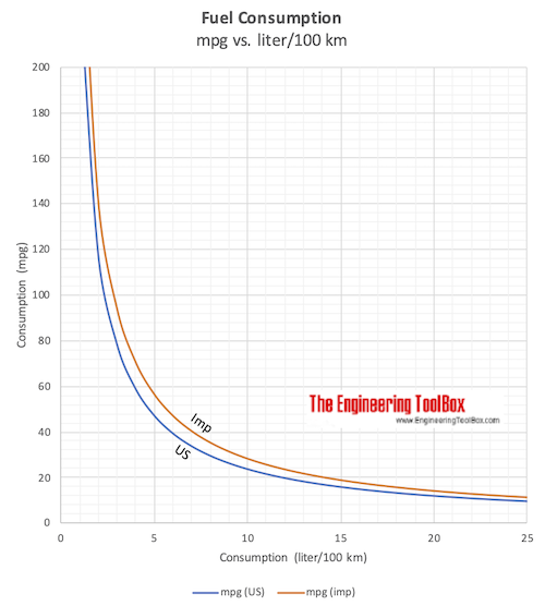

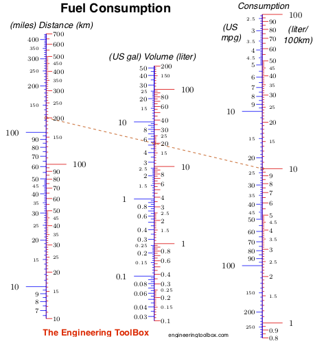

Fuel Consumption Charts
Use the chart below to estimate fuel efficiency. The default values are for distance 200 km, volume 200 liter and consumption 10 liter/100 km.
Download and print scalable Fuel Consumption Chart!
Fuel consumption - liter per 100 km vs US and Imperial mpg
