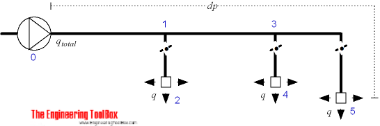

1. Compute the air volume in every room and branch
Use the actual heat, cooling or air quality requirements for the rooms and calculate required air volume flow - q.
2. Compute the total volume flow in the system
Make a simplified diagram of the system like the one above.
Use 1) to summarize and accumulate total air volume flow - qtotal - in the system.

5. Determine the duct sizes throughout the system
Use the static pressure drop from 4) as a constant to determine the ducts sizes throughout the system. Use the air volumes calculated in 1) for the calculation. Select the duct sizes with the pressure drop for the actual ducts as close to the main duct pressure drop as possible.
6. Determine the total resistance in the system
Use the static pressure from 4) to calculate the pressure drop through the longest part of the duct system. Add minor loss by using equivalent lengths or minor loss coefficients as used in the example spreadsheet below.
7. Calculate balancing dampers
Use the total resistance in 6) and the volume flow throughout the system to calculate dampers and their theoretical pressure loss.
