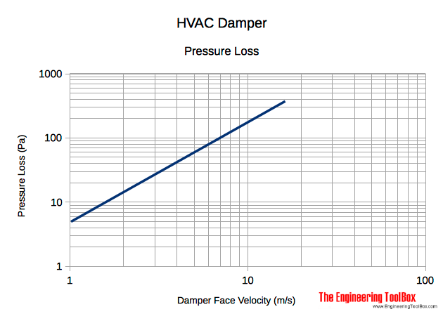

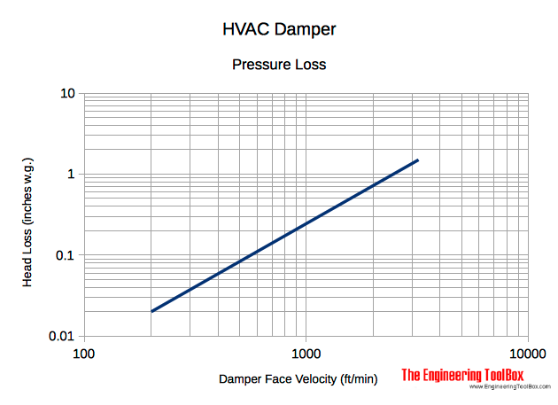

Pressure head loss in HVAC dampers.
Typical pressure - or head - loss in a HVAC damper:
HVAC damper pressure head loss
HVAC damper pressure head loss SI
