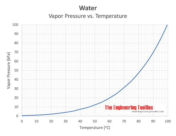

Vaporization pressure depends of fluid temperature. The vapor pressure for water - our most common fluid - is indicated below:
Cavitation - Water Vapor Pressure vs. Temperature

Note! - be aware that evaporation pressure - and possible cavitation - increases dramatically with water temperature.
Water - evaporation pressure vs temperature
Cavitation can be avoided by locating components to the coldest part of systems. Example - it is common to locate pumps and modulating valves in heating systems in the "cold" return lines before heaters and heat-exchangers.
