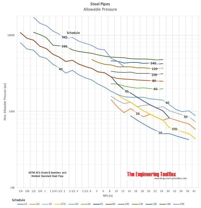

Maximum working pressure of carbon steel pipe at temperature 400oF.
Maximum allowable pressure is calculated with the Barlow's formula for A53 Grade B Seamless and Welded Standard Steel Pipe with Yield Strength 35000 psi and design factor 0.7.
Allowable stress used in the Barlow's formula is calculated as
(35000 psi) 0.7 = 24500 psi
Note! - in codes like ASME B31.3 modified versions of the Barlow's formula - like the Boardman formula and the Lame formula - are used to calculate burst and allowable pressures and minimum wall thickness.
The dimensions - outside pipe diameters and wall thicknesses are according ANSI B36.10.
For full table with higher Schedules - rotate the screen!

  • 1 in (inch) = 25.4 mm
  • 1 psi (lb/in2) = 6894.8 Pa (N/m2) = 6.895x10-2 bar
A53b steel pipes - allowable pressure vs schedule
