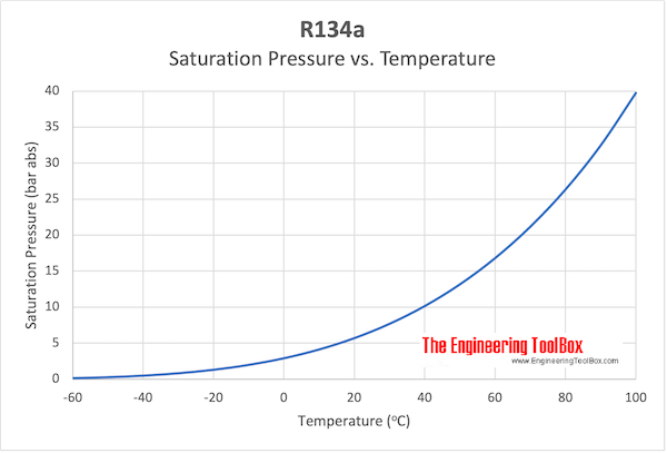

R134a - Saturation pressure vs. temperature
