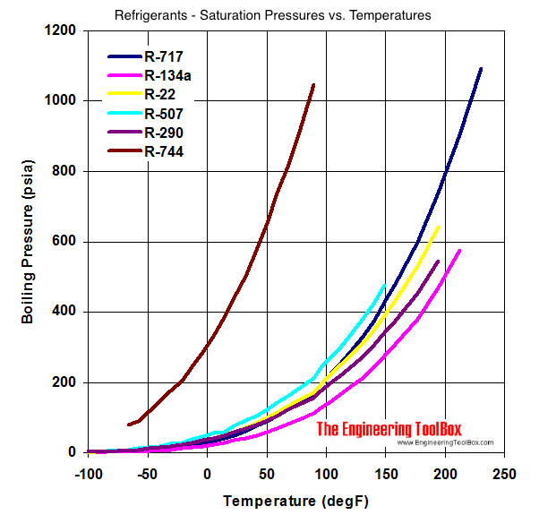

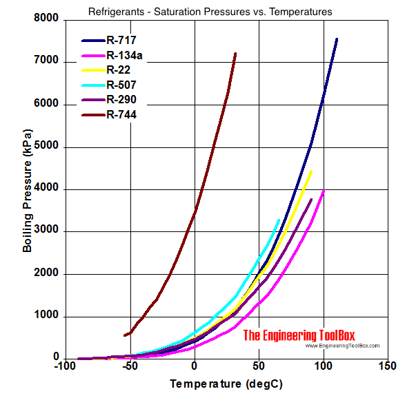

Refrigerants - Saturation Pressures vs. Temperatures
Temperature and pressure diagram for constant boiling refrigerants - imperial and SI units.
The relation between temperatures and boiling pressuress for
  • R-717 : Ammonia
  • R-134a : Tetrafluoroethane
  • R-22 : Hydrochlorofluorocarbon
  • R-507 :
  • R-290 : Propane
  • R-744 : CO2
are indicated in the diagrams below:
temperature-pressure refrigerants boiling points diagram
