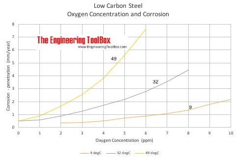

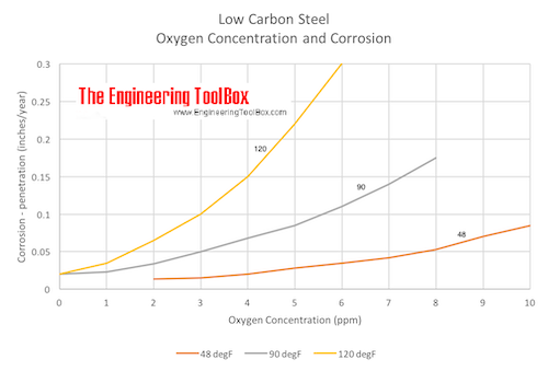

Corrosion of steel is strongly affected by the amount of oxygen in the water and the temperature of the water. The effects of oxygen and temperature on low-carbon steel pipes with water flow are indicated in the diagrams below:
Corrosion of low-carbon steel pipes - oxygen concentration and temperature - degrees Fahrenheit
The diagrams indicates clearly how important it is to avoid continuously fresh water supply in higher temperature systems - like heating systems or similar - where the piping is made of carbon steel.
