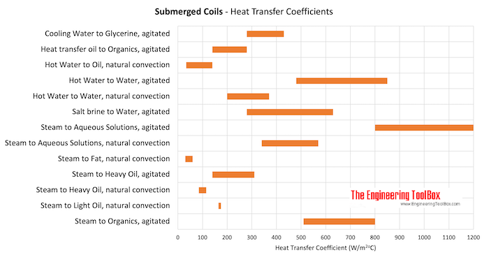

The overall heat transfer coefficients for steam coils with medium pressure -  or hot water coils or pipes -  submerged in oil or fat:
Submerged Coils - Heat Transfer Coefficients
Type of CoilHeat Transfer Coefficient
- U -
(W/m2 oC)(Btu/hr ft2 oF)
Steam to Aqueous Solutions, agitated 800 - 1200 140 - 210
Steam to Aqueous Solutions, natural convection 340 - 570 60 - 100
Steam to Light Oil, natural convection 170 30
Steam to Heavy Oil, natural convection 85 - 115 15 - 20
Steam to Heavy Oil, agitated 140 - 310 25 - 55
Steam to Fat, natural convection 30 - 60 5 - 10
Steam to Organics, agitated 510 - 800 90 - 140
Hot Water to Oil, natural convection 34 - 140 6 - 25
Hot Water to Water, natural convection 200 - 370 35 - 65
Hot Water to Water, agitated 480 - 850 90 - 150
Heat transfer oil to Organics, agitated 140 - 280 25 - 50
Salt brine to Water, agitated 280 - 630 50 - 110
Cooling Water to Glycerine, agitated 280 - 430 50 - 75
