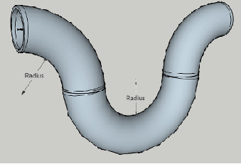

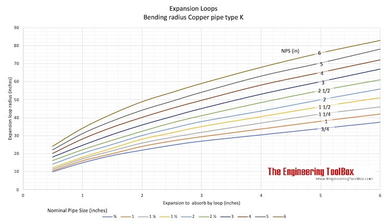

Expansion loop capacities of copper tubes type K are indicated in the chart below.
Pipe expansion loop
Expansion loop capacity - copper pipe type k
Piping should be pre-stressed when anchored to minimize the stress in the system under normal operating conditions.
