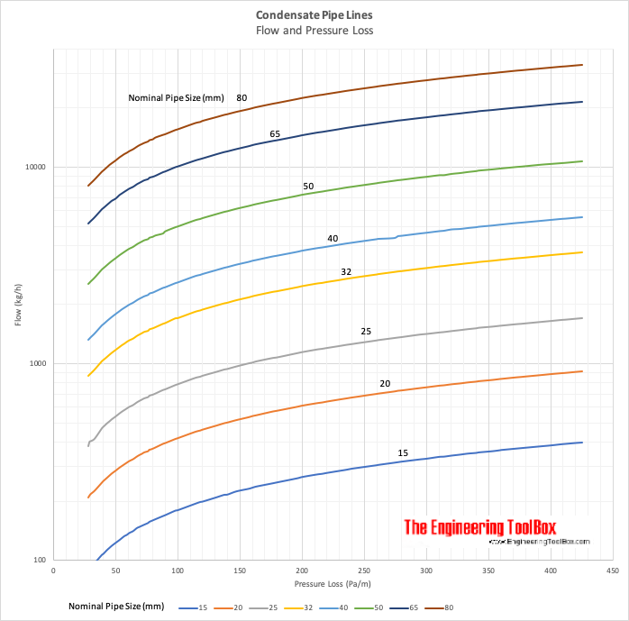

Flow and pressure loss in condensate return lines - SI Units.
When sizing condensate return lines in steam distribution system - remember that the maximum condensate flow is achieved during plant start up when pipes and equipment are heated up.
A rule of thumb - the condensate load used to design condensate pipe lines should be twice the maximum production load.

Equipment Piping and Condensate Load
Typical maximum condensate load and equipment outlet pipe size:
| Maximum Condensate Load (kg/h) | Outlet Pipe Size (mm, (in)) |
| 200 | 15 (1/2) |
| 500 | 20 (3/4) |
| 1000 | 25 (1) |
| 2000 | 32 (1 1/4) |
| 3000 | 40 (1 1/2) |
| 5000 | 50 (2) |
| > 5000 | 65 - 100 (2 1/2 - 4) |
