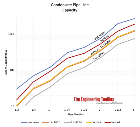

Maximum capacities for condensate pipe lines in kW steam consumption.
The table below can be used to determine the sizes of a condensate pipe line where the heat consumption in kW is known.

Condensate pipe lines capacity in kW vs. pitch slope
Download and print Condensate Pipe Line Capacity diagram
