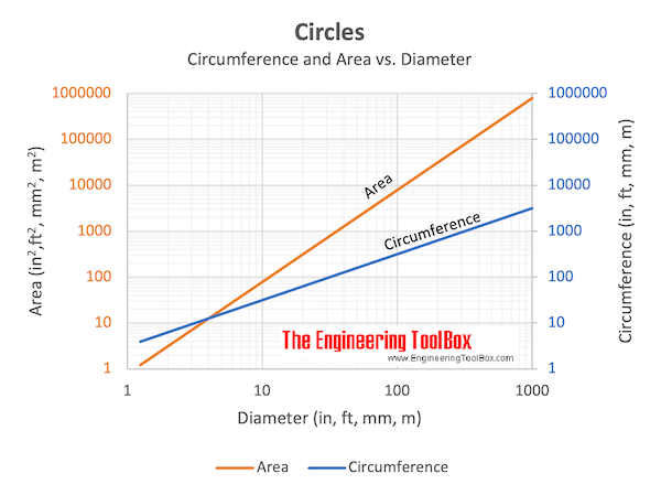

Circles - Circumference and Area vs. Diameter chart
Download and print Circumference and Area vs. Circle Diameter chart
Circumference and area vs circle diameter:
