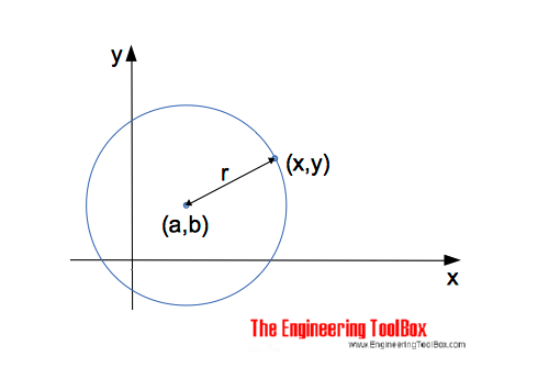

Standard Form
The standard form for the equation of a circle can be expressed as
(x - a)2 + (y - b)2 = r2                            (2)
a = x coordinate position of the circle center
b = y coordinate position of the circle center
r = circle radius
General Form
The general form for the equation of a circle can be expressed as
x2 + y2 + A x + B y + C = 0                                  (3)
A, B, C = constants
Radius of circle
r = (a2 + b2 - C) 1/2                                       (4)
Coordinates in the Circle Centre
a = - A / 2                                   (5a)
b = - B / 2                                   (5b)
