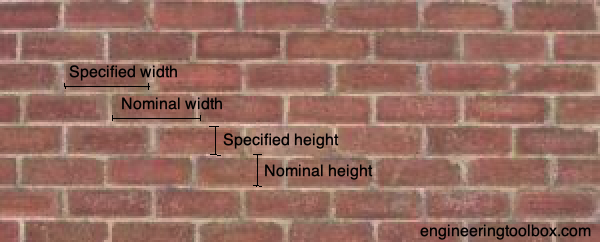

Bricks wall
Brick Size
Bricks - Required Quantity
TypeNominal Size
(in)
Actual (Specified) Size
(in)
No. per Square Foot
Standard 4 x 2 2/3 x 8 3 5/8 x 2 1/4 x 8 6.3
Modular 4 x 2 2/3 x 8 3 5/8 x 2 1/4 x 7 5/8 6.9
King 3 3/8 x 3 x 10 3 x 2 5/8 x 9 5/8 4.8
Queen 2 3/4 x 3 x 10 3 1/8 x 2 3/4 x 9 5/8 4.6
Engineer 4 x 3 1/5 x 8 3 5/8 x 2 13/16 x 7 5/8 5.7
Economy 4 x 4 x 8 3 5/8 x 3 5/8 x 7 5/8 4.5
Utility 4 x 4 x 12 3 5/8 x 3 5/8 x 11 1/2 3.1
Jumbo 4 x 3 x 8 3 5/8 x 2 3/4 x 8 5.5
Norman 4 x 2 2/3 x 12 3 5/8 x 2 1/4 x 11 5/8 4.6
Jumbo Norman 4 x 3 x 12 3 5/8 x 2 3/4 x 11 5/8
Norwegian 3 1/2 x 3 x 12 3 1/2 x 2 3/4 x 11 5/8 3.9
  • actual or specified width and height - without mortar joint
  • nominal width and height - including mortar joint
  • the predominant mortar joint width used in construction is 3/8"

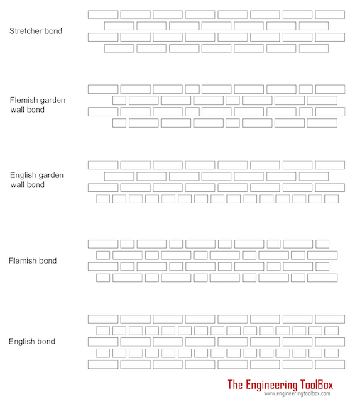

Brick Walls - Selected Bond Patterns
  • Stretcher bond
  • Flemish garden wall bond
  • English garden wall bond
  • Flemish bond
  • English bond
Bricks Wall - Selected Bonds Patterns

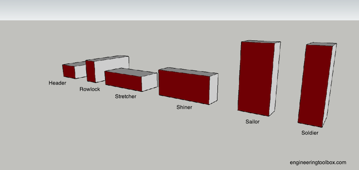

Brick Orientation
  • stretcher
  • shiner
  • soldier
  • sailor
  • header
  • rowlock
Brick orientation - stretcher, shiner, soldier, sailor, header, rowlock
