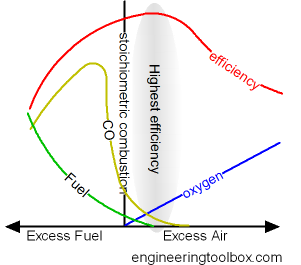

To ensure complete combustion of the fuel used combustion chambers are supplied with excess air. Excess air increase the amount of oxygen to the combustion and the combustion of fuel.
  • when fuel and oxygen from the air are in perfect balance - the combustion is said to be stoichiometric
The combustion efficiency increases with increased excess air - until the heat loss in the excess air is larger than the heat provided by more efficient combustion.
combustion excess air CO fuel

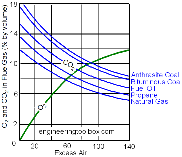

Carbon dioxide - CO2 - is a combustion product and the content of CO2 in a flue gas is an important indication of the combustion efficiency.
combustion efficiency and excess air
Optimal content of carbon dioxide CO2 after combustion is approximately 10% for natural gas and approximately 13% for lighter oils.

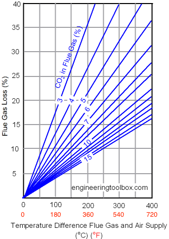

Flue Gas Loss with Oil Combustion
The efficiency loss in the flue gas related to
  • temperature difference in flue gas and supply air
  • CO2 concentration in the flue gas
with oil combustion is indicated below:
flue gas efficiency
Example - Oil Combustion and Heat Loss in the Flue Gas
If
  • the temperature difference between the flue gas leaving a boiler and the ambient supply temperature is 300 oC, and
  • the carbon dioxide measured in the flue gas is 10% - then,
from the diagram above
  • the flue gas loss can be estimated to approximately 16%.
