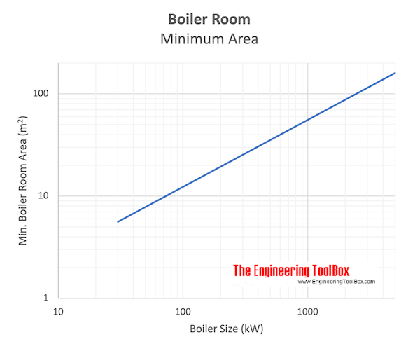

The required area and volume of a boiler room is influenced by the combustion technology used - where combustion and handling of coal requires a lot more space than combustion of gas or oil.
The diagram below can be used to indicate the minimum space required for boilers combustion oil.
boiler room area
