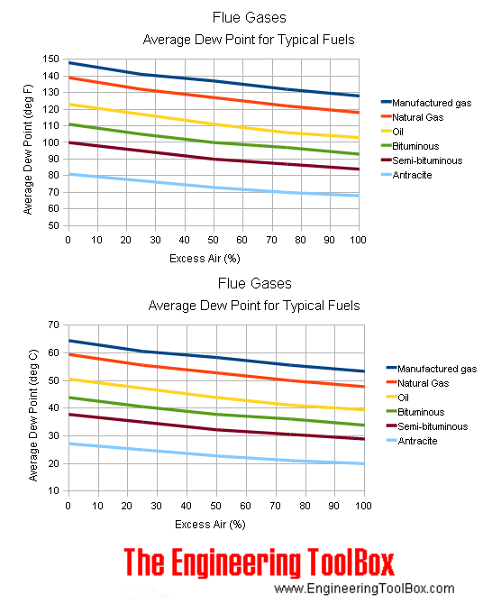

Flue gas dew point temperatures for some fuels.
Average dew point temperatures for typical fuels like
  • anthrasite
  • bituminous
  • manufactured gas
  • natural gas
  • oil
  • semi-bitumius
are indicated in the charts below
Average dew point of flue gases for typical fuels
Excess air is the ratio of air supplied to the combustion process to what is theoretically required for perfect combustion (stoichiometric combustion).
