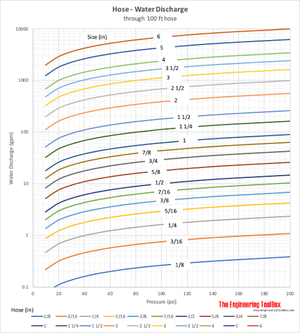

Hose - Water Discharge - Imperial Units
Water discharge through 100 feet hoses - at pressures ranging 10 - 200 psi:
Water flow discharge through hose - imperial units gpm, psi
Download and print Hose Water Discharge Chart
  • 1 psi = 6.9 kPa = 0.069 bar
  • 1 ft (foot) = 0.3048 m
  • 1 gal (US)/min =6.30888x10-5 m3/s = 0.227 m3/h

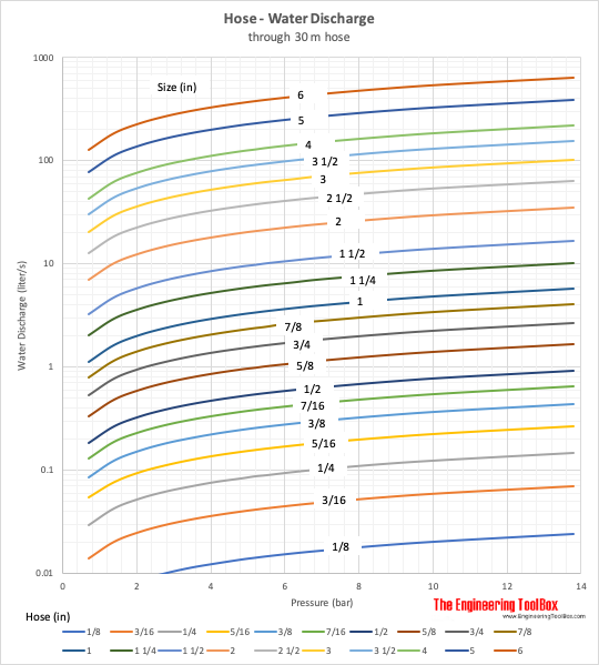

Hose - Water Discharge - Metric Units
Water discharge through 30 m hoses - at pressures ranging 0.75 - 14 bar:
Water flow discharge through hose - metric units bar, liter per second
