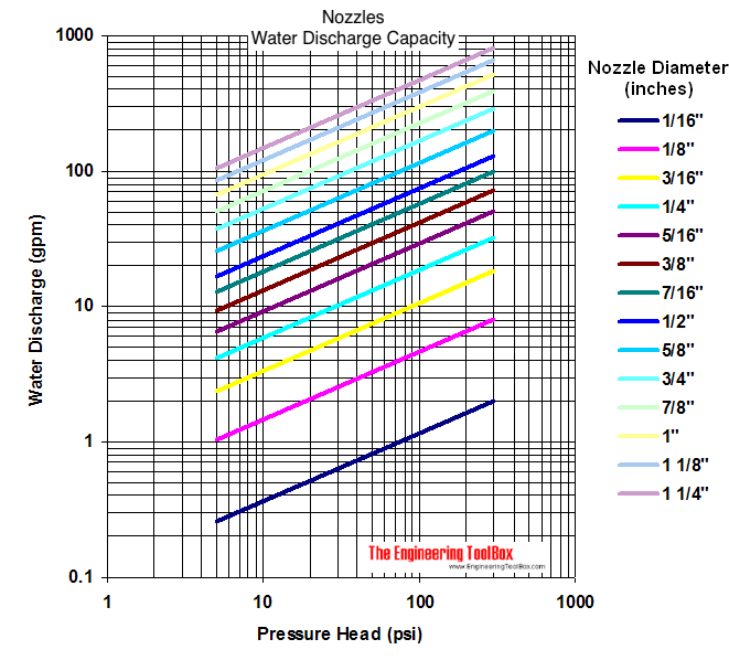

Discharge capacities of water nozzles.
Water discharge capacity through nozzles:
Water nozzles - discharge capacity diagram
  • water temperature 60oF (15.6oC)
  • 1 in (inch) = 25.4 mm
  • 1 psi (lb/in2) = 144 psf (lbf/ft2) = 6,894.8 Pa (N/m2) = 6.895x10-3 N/mm2 = 6.895x10-2 bar = 27.71 in H2O at 62oF (16.7oC) = 703.1 mm H2O at 62oF (16.7oC) = 2.0416 in mercury at 62oF (16.7oC) = 51.8 mm mercury at 62oF (16.7oC) = 703.6 kg/m2 = 0.06895 atm = 2.307 ft H2O
  • 1 gal (US)/min (gpm) =6.30888x10-5 m3/s = 0.227 m3/h
