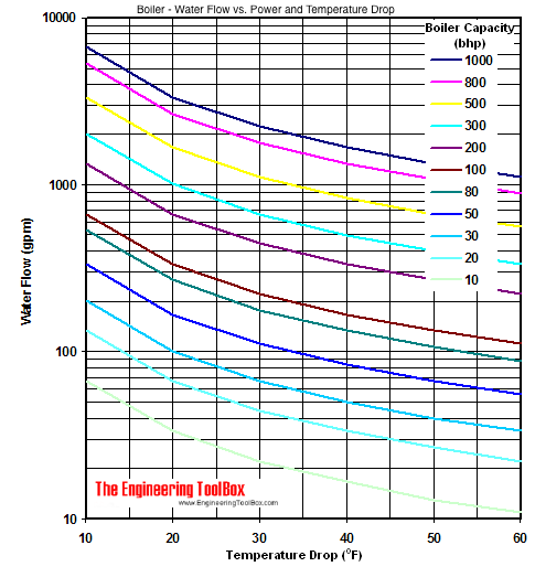

Water Circulation - Boiler Capacity in BHP - Temperature drop in degrees Fahrenheit
Hot-water generators - water circulation rates bhp
  • 1 gal (US)/min = 6.30888x10-5 m3/s = 0.0227 m3/h = 0.06309 dm3(liter)/s = 2.228x10-3 ft3/s = 0.1337 ft3/min = 0.8327 Imperial gal (UK)/min
  • 1 hp (English horse power) = 745.7 W = 0.746 kW = 550 ft lb/s = 2,545 Btu/h

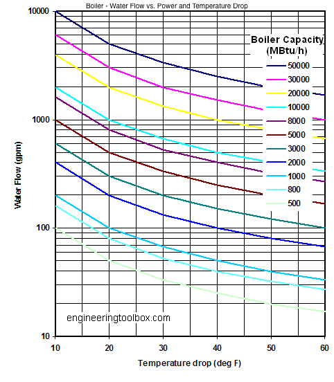

Water Circulation - Boiler Capacity in MBtu/h - Temperature drop in degrees Fahrenheit
Hot-water generators - water circulation rates - MBtu/h
  • 1 Btu/h = 0.293 W

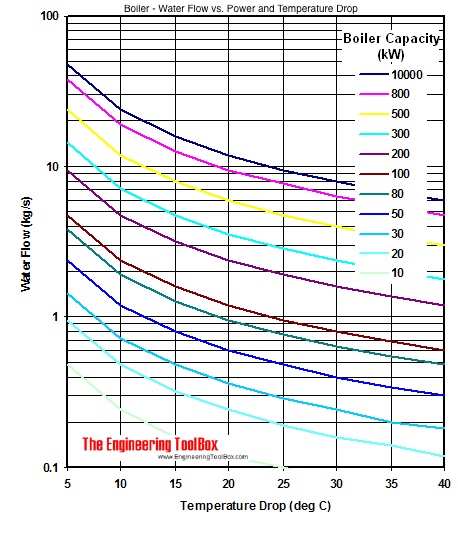

Water Circulation - Boiler Capacity in kW - Temperature drop in degrees Celsius
Hot-water generators - water circulation rates - kW
  • 1 kW = 3,412 Btu/h = 1.341 British hp
Example - Water flow through Boiler
A boiler with capacity 50 kW increases the temperature of the circulated water with 20oC - the water flow through the boiler according the diagram above is
0.6 kg/s
