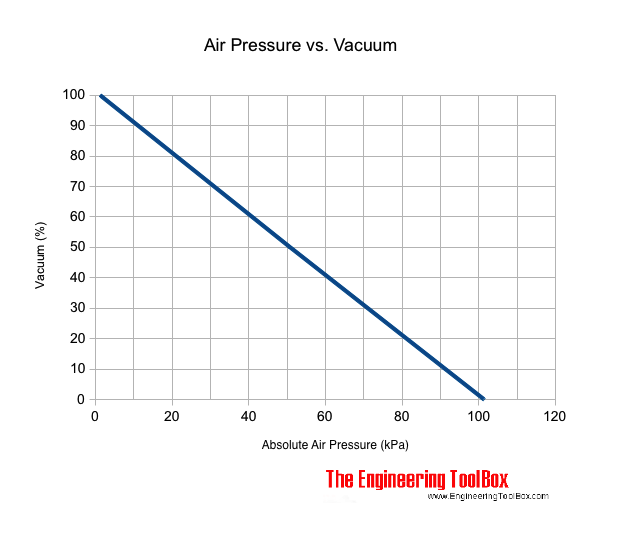

Vacuum versus Absolute Air Pressure
air pressure versus vacuum
Example - Vacuum
If the absolute pressure is 60 kPa the vacuum according the diagram above is approximately 40 % - or approximately 450 Torr .
