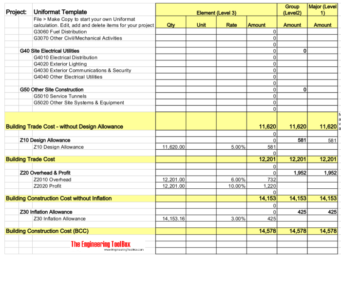

Uniformat - online calculation template
You must be signed into your Google Account to open, save a copy and modify the Uniformat Calculation Template.
