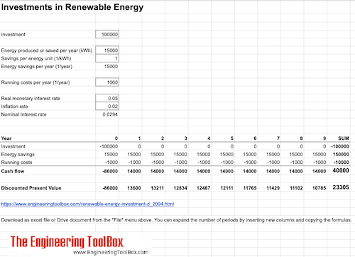

Example - Investment In Renewable Energy - Discounted Cash Flow
- how to calculate discounted net present value in a typical renewable energy project

Example - Investing in a Solar Power System
An investment of 30000 in a solar power system saves an amount of 1000 on the electricity bill the first year. The electricity price is in the future assumed to rise 10% (growth rate) each year. The alternative use of the money is to invest in a savings account with 3% interest rate (discount rate).
The lifespan of the solar power system is estimated to 20 years (no. of periods).
Using these values in the calculator above gives
P = 12819
IRR = 6.1 %
- and the investment is profitable compared to the savings account.
Using the same values - but for a shorter lifespan of 15 years - gives
P = - 3581
IRR = 1.6 %
- and the investment is not profitable compared to the savings account.
