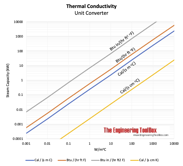

Thermal Conductivity - Unit Converting Table
Convert between thermal conductivity units - table and diagram.
Thermal conductivity - k - indicates a materials ability to conduct heat.

Thermal Conductivity - Unit Converter Chart
Download and print Thermal Conductivity - Unit Converting Chart
