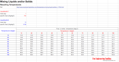

Mixed Temperature Calculator
The calculator below is based on eq. 1 and can be used to calculate the final - strike - temperature when two liquids or solids - or a liquid and a solid - is mixed together.
Mixing Liquids and/or Solids - Final Temperatures Spreadsheet Calculation
The Google Docs spreadsheet below can be used to calculate final temperature when mixing fluids or solids. You can copy or download the spreadsheet to make your own copy.
Mixing fluids and/or solids - final temperature
