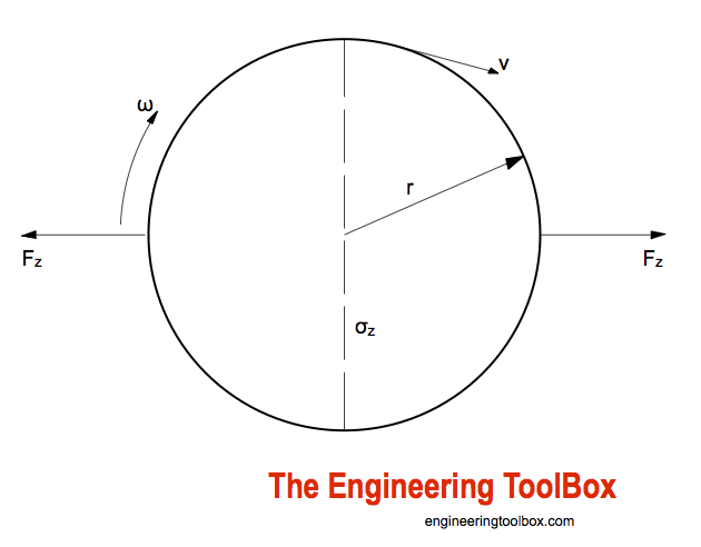

Stress in a Rotating Disc
Stress in rotating disc
Stress in a rotating disc can be calculated as
σ z = ω2r2ρ / 3
= v2ρ / 3
= ( 2 π n / 60)2r2ρ / 3 (1)
σ z = stress (Pa, N/m2)
ω = angular velocity (rad/s)
r = radius of disc (m)
ρ = density (kg/m3 )
π = 3.14...
n= revolutions per minute (rpm)

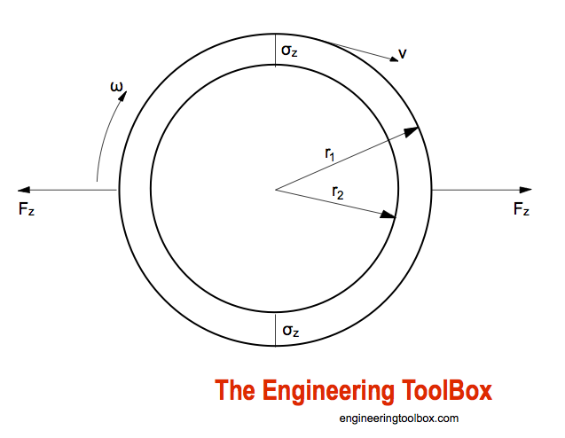

Stress in a Rotating Ring
Stress in rotating ring
Stress in a rotating ring can be calculated as
σ z = ω2ρ ( r12+ r1 r2+ r2 2 ) / 3                     (2)
r1 = outer radius of ring (m)
r2= inner radius of ring (m)
For a thin ring the equation can be simplified to
σ z = ω2ρ r                    (3)
r  = mean radius of ring (m)
