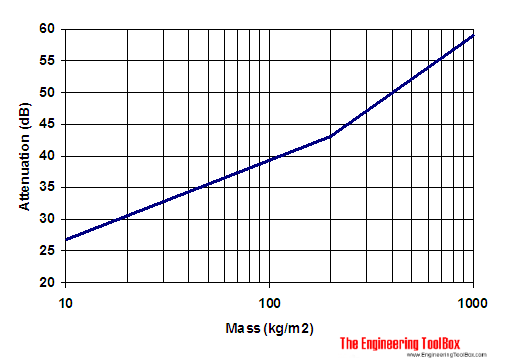

The sound transmission through a massive wall or floor depends primarily on the mass of the construction.
Mean attenuation through a massive construction is indicated in the diagram below:
Sound attenuation - massive walls floors
Note! - more mass - more attenuation!
The attenuation for a specific frequency can be calculated by adding the value in the table below to the mean value indicated in the chart above.
Sound Transmission through Massive Walls or Floors - Frequency Correction

Example - A Concrete Floor and Sound Attenuation
Sound transmission massive floors
The mass m of a concrete floor with density 2300 kg/m3 and thickness 0.2 m can be calculated as
m = (2300 kg/m3) (0.2 m)
    = 460 kg/m2
From the chart above the mean sound attenuation for the floor can be estimated to
52 db
The attenuation dL at 250 Hz can be calculated as
dL = (52 db) + (- 5 dB)
    = 47 dB
The attenuation at 2000 Hz can be calculated as
dL = (52 db) + (7 dB)
    = 59 dB
