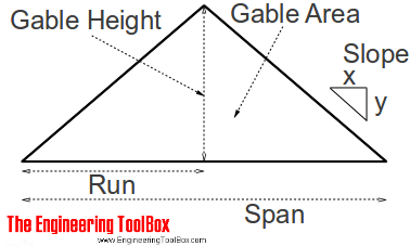

Roof Framing
Run, roof slope, gable height and gable area.
Roof framing - run gable height area
Run
Run can be calculated as:
R = S / 2                        (1)
R = run (ft, m)
S = span (ft, m)
Example - Run
The run of a roof with 60 feet span is
R = (60 feet) / 2
  = 30 feet
Gable Height
Gable height can be calculated as
GH = R VR                       (2)
GH = gable height (ft, m)
R = run (ft, m)
VR = vertical rise (in/ft, cm/m)
Example - Gable Height
The Gable Height of a roof with 30 feet run and vertical rice 6 inches per foot, can be calculated as
GH = (30 feet) (6 inches/foot)
     = 180 inches
     = 15 feet
Gable Area
Gable Area can be calculated as
GA = GH R                        (3)
GA = gable area (sq.ft, m2)
R = run (ft, m)
Roof Slope
Roof slope is the ratio between the vertical rise and the horizontal run:
RS = y / x                      (4)
RS = roof slope
y = vertical rise (in, m)
x = horizontal run (in, m)
