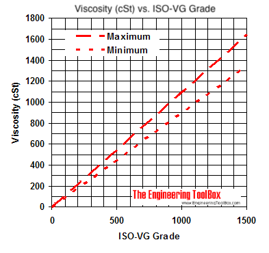

ISO-VG viscosity grades for industrial lubricants.
The diagram below indicates the minimum and maximum viscosities in centistokes for equivalent ISO-VG grades at temperature 40oC.
Lubricants - Iso-vg grade viscosity diagram
ISO VG stands for "International Standards Organization Viscosity Grade" and is a number ranged from 2 to 1500.

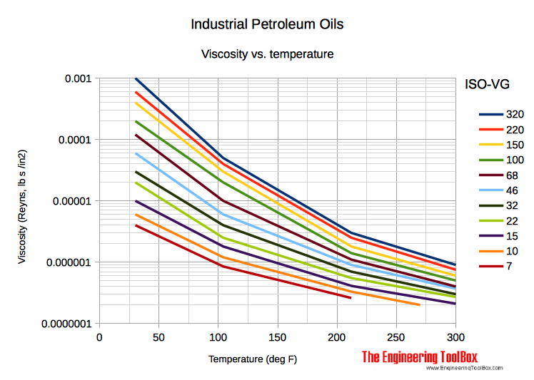

ISO-VG Grades - Absolute Viscosity vs. Temperature, Reyns vs. Fahrenheit
Lubricants - Iso-vg temperature absolute viscosity diagram

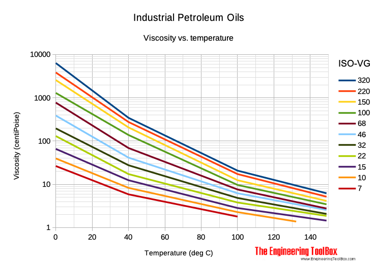

ISO-VG Grades - Absolute Viscosity vs. Temperature, centiPoise vs. Celsius
Lubricants - Iso-vg temperature absolute viscosity diagram - centiPoise vs. Temperature
  • tC = 5/9(tF - 32)
  • tF = 9/5 tC + 32
  • 1 reyns (lb s/in2) = 6896.55 (Pa s)
  • 1 cSt (centiStoke) = 1 centiPoise / SG
  • SG = specific gravity of oil
