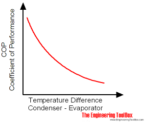

COP - Coefficient of Performance
The Coefficient of Performance - COP - is the ratio of heat output to the amount of energy input for a heat pump.
COP - heat pump efficiency
COP can be expressed as
COP = hh / hw                                            (1)
COP = Coefficient of Performance
hh = heat produced (Btu/h, J, kWh)
hw = equivalent electric energy input (Btu/h, J, kWh) = 3413 Pw
Pw = electrical input energy (W)
If a heat pump delivers 3 units of heat for every unit of energy input - the COP is 3.

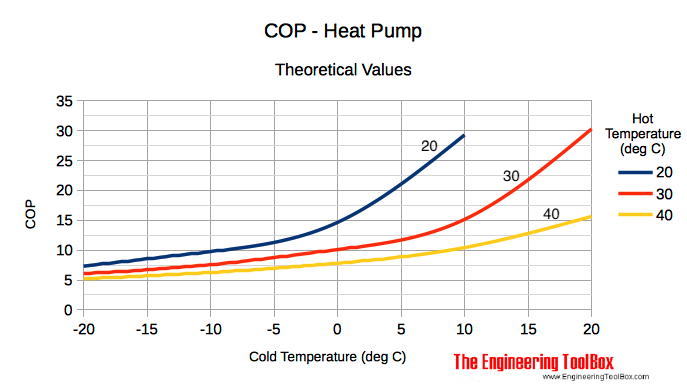

Maximum COP
Maximum theoretical efficiency for a heating process is
COPheating = Th / (Th - Tc)                                               (1b)
COPheating = Coefficient of Performance - heating process
Th = absolute temperature on the hot side (K)
Tc = absolute temperature on the cold side (K)
Maximum theoretical efficiency for a cooling process is
COPcooling = Tc / (Th - Tc)                                             (1c)
COPcooling = Coefficient of Performance - cooling process
Note! - the efficiency of a cooling or heating process can be increased by reducing the temperature difference (Th - Tc) between the hot and cold side.
A heating process with a lower hot temperature - like achievable in a piped floor system - will increases the efficiency compared to a system with higher hot temperature - like a heating panel system. The opposite for a cooling process - a lower cold temperature will increase the efficiency.
COP heat pump theoretical
Example - Maximum Heat Pump Efficiency
An air to air heat pump operates between temperature -5 oC on the cold side and temperature 40 oC on the hot side. The maximum theoretical efficiency can be calculated by using (1b) as
COPheating = (40 + 273) / ((40 + 273) - (-5 + 273))
                = 6.95
The typical practical value for a heat pump is in the range 2 - 4.
