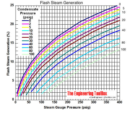

When condensate passes steam traps - flash steam is generated.
The amount of flash steam generated depends on steam pressure - the pressure in the condensate before it leaves the condensate trap - and the condensate pressure after the trap - the pressure in the condensate return pipe lines.
The diagram and table below indicates the ratio of flash steam generated at different pressures before and after condensate traps:
Flash steam generation diagram - in psig
Flash Steam Generated from Condensate vs. Steam Pressure

1) It is common to vent the condensate system to the atmosphere - where the gauge pressure is 0 psig.
  • 1 psi (lb/in2) = 6,894.8 Pa (N/m2) = 6.895x10-3 N/mm2 = 6.895x10-2 bar
Example - Generated Flash Steam
A condensate system is vented to the surroundings and the pressure in the condensate return system after the steam traps is therefore 0 psig (atmospheric pressure).  The steam pressure before the steam traps is 160 psig.
According the table above 16.8% of the condensate evaporates as flash steam passing the traps.
Note! Without any flash recovery system the energy in the flash steam will be lost to the surroundings.
