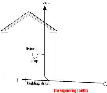

Individual vents
Individual vents serve individual fixtures.
Sewage vent - individual
This vents only one fixture but may connect into an other vent that extends to open air.
  • an individual vent should be at least one-half the size of the drain it vents (no less than 1 1/4", 32 mm)

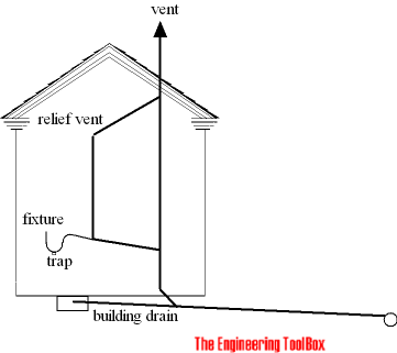

Relief vents
Relief vents provide additional air to the drainage system where the primary vent is too far from the fixture.
Sewage vent - relief
  • an relief vent should be at least one-half the size of the drain it vents (no less than 1 1/4", 32 mm)

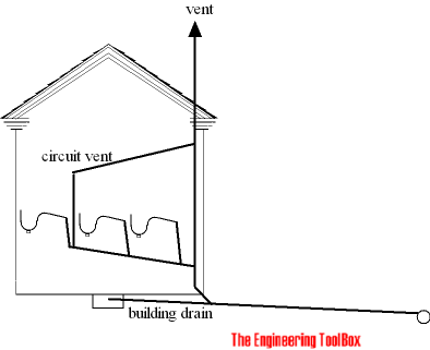

Circuit vents
Circuit vents are used with more than one fixtures. A circuit vent is installed before the last fixture extend up to open air or connects to an other vent that extend to the outside
Sewage vent - circuit
  • an circuit vent should be at least one-half the size of the drain it vents (no less than 1 1/4", 32 mm)

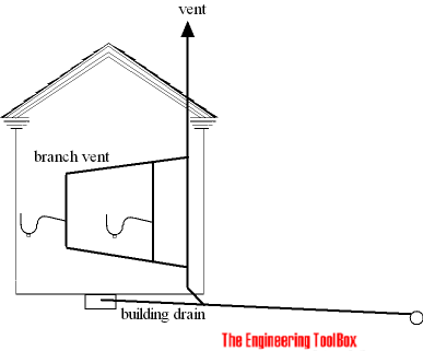

Branch vents
Branch vents are vents extending horizontally that connects multiple vents together.

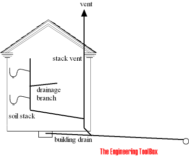

Stack vents
A vent stack is used only for the purpose of venting.
Sewage vent - soil stack
