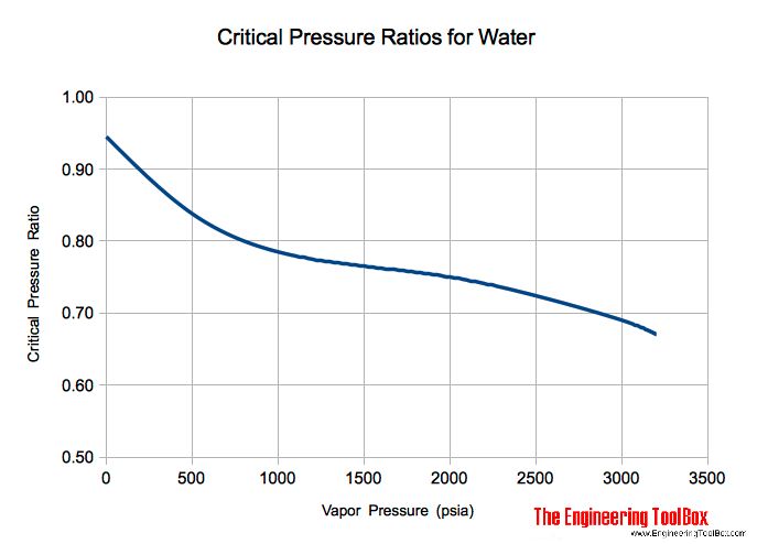

Critical pressure ratios for water:
Water - critical pressure ratio

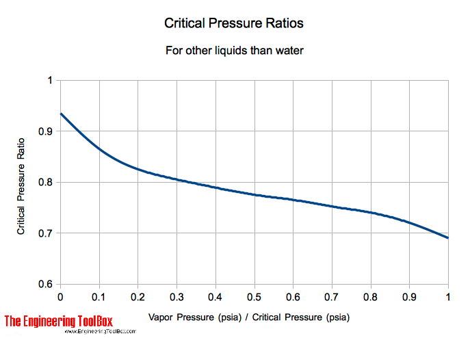

Critical pressure ratios for liquids other than water:
Liquids - critical pressure ratios
