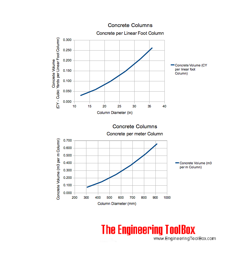

Concrete required per 1 ft Column Height
Concrete Columns - Round Column Volume
Column Size
(in)
Volume
(cy - cubic yards - per linear foot Round Column)
8 0.013
9 0.016
10 0.020
11 0.024
12 0.029
14 0.040
16 0.051
18 0.065
20 0.081
22 0.097
24 0.116
26 0.137
28 0.158
30 0.181
