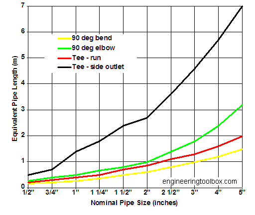

Pressure drop in compressed air pipe line fittings can be expressed as equivalent length in meters of  pipe line.

90o bend 0.15 0.2 0.25 0.35 0.5 0.6 0.8 1.0 1.2 1.5
90o elbow 0.25 0.4 0.5 0.65 0.8 1.0 1.4 1.8 2.4 3.2
Tee - run 0.2 0.3 0.4 0.5 0.7 0.85 1.1 1.3 1.6 2.0
Tee - side outlet 0.5 0.7 1.4 1.8 2.4 2.7 3.6 4.6 5.7 7.0
Example - Compressed Air Pipe Line and Equivalent Length
A 90o bend equals to a 0.6 m50 mm pipe line.
