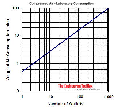

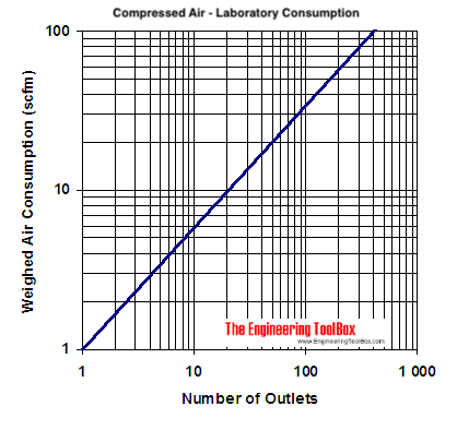

The typical total demand for compressed air in laboratories due to diversity and simultaneous use are indicated in the diagrams below. All outlets for compressed air are newer used at the same time.
Compressed Air - cfm
compressed air laboratory demand diagram - cfm
  • 1 scfm per outlet used
Compressed Air - l/s
compressed air laboratory demand diagram - l/s
  • 0.5 nl/s per outlet used
Example - Compressed Air Supply to a Laboratory
For a laboratory with 10 outlets the compressed air supply should be sized for a capacity of 3 nl/s.
