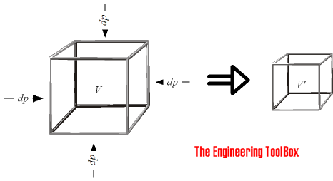

The Bulk Modulus Elasticity - or Volume Modulus - is a material property characterizing the compressibility of a fluid - how easy a unit volume of a fluid can be changed when changing the pressure working upon it.
The Bulk Modulus Elasticity can be calculated as
K = - dp / (dV / V0 )
= - ( p1 - p0 ) / ((V1 - V0 ) / V0 )                       (1)
K = Bulk Modulus of Elasticity (Pa, N/m2)
dp = differential change in pressure on the object (Pa, N/m2)
dV = differential change in volume of the object (m3 )
V0 = initial volume of the object  (m3 )
p0 = initial pressure ( Pa, N/m2)
p1 = final pressure ( Pa, N/m2)
V1 = final volume ( m3 )
