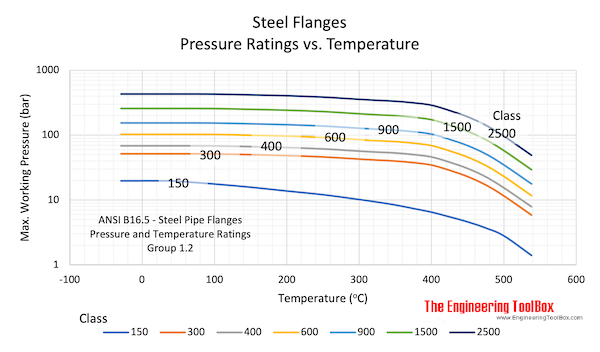

The values in this table apply to materials Group 1.2
For other Material Groups the Pressure-Temperature Ratings are different. Most carbon steels are only acceptable for temperatures below 800 F.
Steel Flanges - working pressure vs. class and temperature
