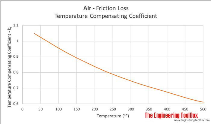

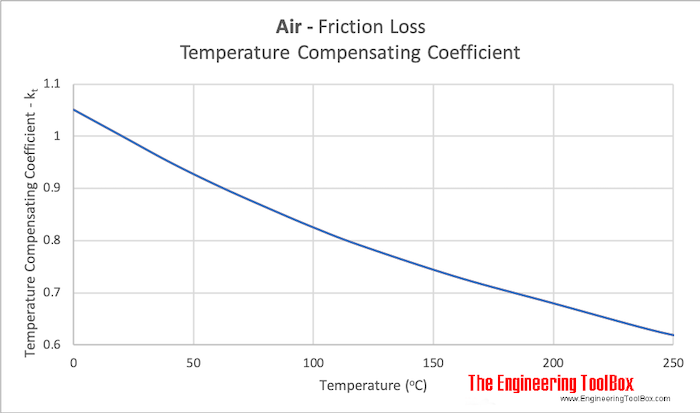

"Temperature Compensating Coefficient" for various air temperatures:
air ducts friction loss temperature compensation
Example - Air with Temperature 100oC
For air with temperature 100oC the "Temperature Compensating Coefficient" is approximately 0.83. So,
  • the pressure loss in air with temperature 100oC is approximately 83 % of the pressure loss in air at standard NTP conditions 20 oC
