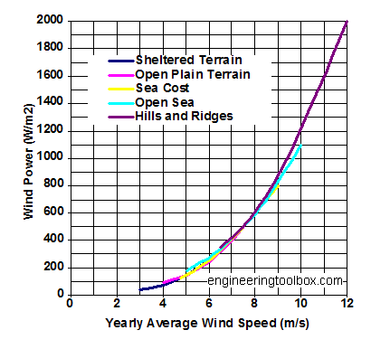

Available wind energy.
Available wind resources as a function of yearly average wind velocity and different typical terrains are indicated in the diagram below.
wind resources - yearly average wind velocity and terrain - diagram
The resources refer to the power present in the wind at level 50 m. Be aware that wind turbine efficiency is typical 20-30%.
Example - Available Wind Resource
The available wind power resource at a sheltered location with average wind velocity 5 m/s is approximately 140 W/m2 from the diagram above. The available energy output per square meter from a wind turbine with efficiency 25% and a operation time 8000 hour a year can be calculated like
(140 W/m2) (25% / 100%) (8000 h/year)
        = 280000 (Wh/m2year)
        = 280 (kWh/m2year)
