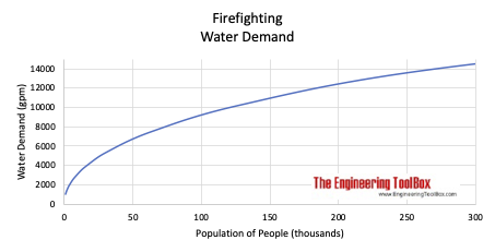

Water demand for firefighting can be estimated as
Q = 1020 n1/2 (1 - 0.01 n1/2)                              (1)
Q = water demand (gpm)
n = population of people (in thousands)
  • 1 US gal/min (gpm) = 0.227 m3/h
Firefighting Water Calculator
Firefighting - Water demand vs. population no. of people
