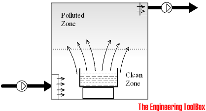

The Displacement Principle
With the displacement principle heat and pollution is transferred from the residence zone close to the floor - to the ceiling where it's evacuated through the outlet system.
displacement ventilation
Make up air is supplied with low velocity very close to the floor. The supply air is normally colder than the average air in the residence zone. The evacuated air close to the ceiling is warmer than the average air in the residence zone.
Activities in the room, people and machines, creates convective air flows from the floor to the ceiling:
  • heat and pollutions are transferred out of the residence zone
  • heat (lights) supplied under the ceiling have limited influence on the temperatures in the room
  • the cooling temperatures of the air supplies are limited to some degrees under the temperature in the residence zone
  • the pollution concentration in the residence zone is limited
The displacement ventilation system is suited for ventilation and cooling systems. The system is not suited for heating.

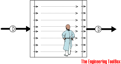

The Piston Principle
In a ventilation system based on the piston principle the supply air moves through the rooms like a "piston".
piston ventilation
The piston principle can be regarded as an extreme variant of the displacement system with a minimum of turbulence in the air flow passing through the room.
  • used in special applications - like clean rooms, operating theaters etc.
Note! To keep the flow "laminar" and stable the air velocity through the room should not be below 0.25 m/s, which requires relatively large volume flows.
