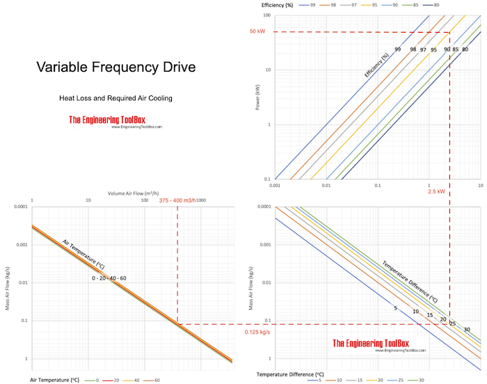

Variable Frequency Drive - Heat Loss Air Cooling Chart
Variable frequency drive - power heat loss and required air cooling chart
Download and print Variable Frequency Drive Heat Loss Air Cooling Chart
Example - Ventilation and Cooling of a Variable-Frequency Drive
The heat generation by the variable frequency drive with maximum power of 100 kW and efficiency of 0.95,can be calculate with eq. 1 as
Hloss = (50 kW) (1 -95 / 100)
      = 2.5 kW
The mass of cooling cooling air through the cabinet when the maximum ambient operating temperature for the frequency drive is 40 oC and outside temperature of the cabinet is 20 oC can be calculated with eq. 2 as
mair = (2.5 kW) / (1.005 kJ/kg oC) ((40 oC) - (20 oC))
      = 0.125 kg/s
The volume and density of air depends on the temperature of the air. The density of air at 20oC is 1.205 kg/m3 and 1.127 kg/m3 at 40 oC.
The volume flow at the inlet (20 oC):
qair = (1 / (1.205 kg/m3)) (0.125 kg/s)
    = 0.104 m3/s
    = 375 m3/h
The volume flow at the outlet (40 oC):
qair = (1 / (1.127 kg/m3)) (0.125 kg/s)
    = 0.111 m3/s
    = 400 m3/h
