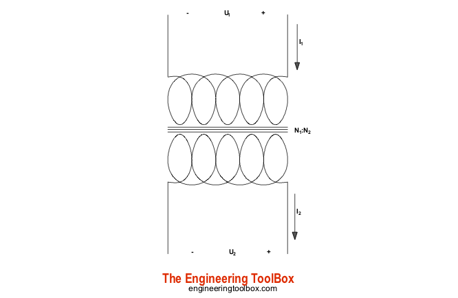

Alternating voltage and induced electro magnetic field - e.m.f. - in a transformer.
A transformer can transfer electrical energy from one electric circuit to an another through inductively coupled conductors.
When current in the primary1 circuit changes, a changing magnetic field will induce a changing voltage in the secondary2circuit .
transformer - primary and secondary coil
For an ideal transformer the induced voltage and current can be expressed as
U1 / U2= N1 / N2= I2/ I1 (1)
U = electrical potential difference (Voltage)
N = number of turns of wire
I = current (Amps)
Example - Secondary Voltage in a Transformer
The secondary voltage in a transformer with 500 primary turns, 3000 secondary turns and 230 V alternating primary current can be calculated as
U2= U1 N2/ N1
= (230 V) 3000 / 500
= 1380 V
= 1.38 kV
